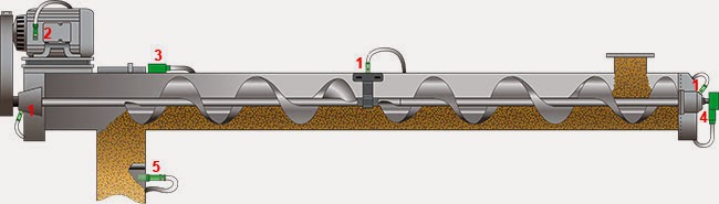

It consists of helicoid (helical flights rolled from flat steel bar) flight, mounted on a pipe on or shaft and turning in a trough. Screw conveyors are preferably used to transport and to dose powder, fine grain or fibrous materials.
Parts of screw conveyor:
- Shaft
- Drive
- Trough
- Helical flights
- Hanger
Classification of screw conveyors by its line of transport:
a. Horizontal screw conveyor.
b. Angular screw conveyor.
c. Vertical screw conveyor.
Principle of operation: The intake end of conveyor is fed with a continuous supply of particulate material. The rotating screw in the trough or pipe will lift the material by a wedging action. The screw will be rotated by drive and supported on bearings. The screws are constructed in different fashion for special applications.
