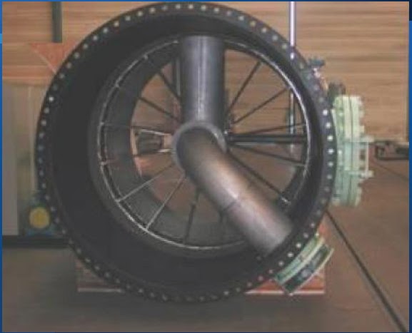

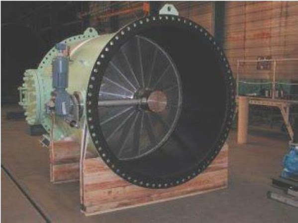

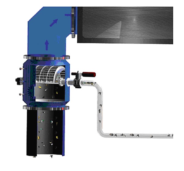

The debris filter replaces a section of the cooling water piping. Water and debris enter into the filter housing, and filtered water exits the screen mesh. Debris larger than the mesh size is trapped over the screen area. Based on the desired setpoint for the increased pressure drop above the clean screen, or on a preset time interval, the debris-cleaning rotor travels over the screen mesh to lift and remove debris from the screen surface. The debris-cleaning cycle lasts only a few minutes. The debris is then discharged into the sewer or into the cooling water discharge from the plant using a small quantity of water.

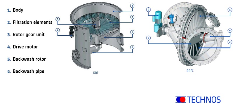

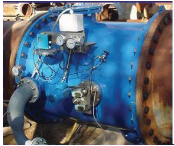

Fixed, semi-spherical shaped filter elements separate the filter area into several independent filter chambers, and consequently no debris can bypass the filter elements. A hood-shaped backwash rotor, located at the raw water side, always covers one filter chamber completely, while a special engineered gear box actuates and rotates the backwash rotor from the clean water side of the filter. The backwash process is automatically initiated by a pressure differential measuring system which monitors debris accumulation permanently.
Not only can the backwash process be triggered automatically by the pressure differential measuring system, the backwash sequence can also be started manually from the local control cabinet.
This is the typical TECHNOS Self-Flushing Debris Filter , and its components shown in the figure above , this system is installed at Most of Thermal Power Station , for its ultimate benefits and advantages .
