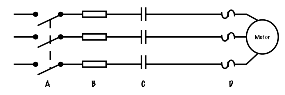

Using the following diagram, answer questions 1 to 5:
Which letter identifies the component that normally provides overcurrent protection for the
motor branch circuit? -
Which letter identifies the component that normally provides overload protection for the
When energized by the control circuit, which letter identifies the component that provides
normal starting and stopping actions? -
Between which two letters is the control circuit power normally taken from?
Which letter(s) identify devices that must be horsepower rated?

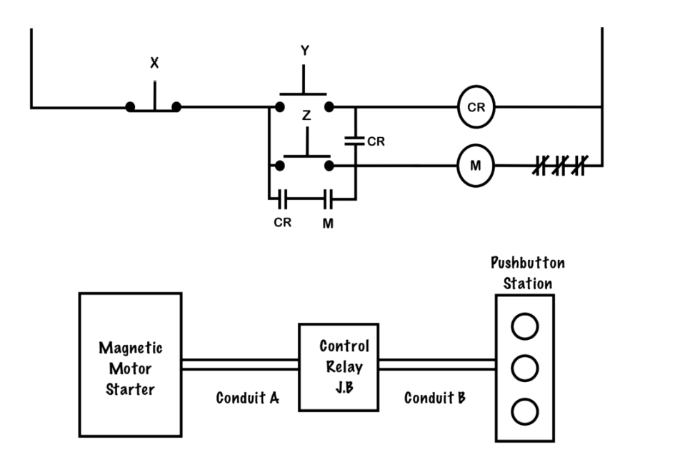

In regards to the drawing, the best label for the pushbutton labelled “Z” would be:
A. Stop
B. Jog
C. Run
D. Reset -
In regards to the drawing, the best label for pushbutton “Y” would be:
A. Stop
B. Jog
C. Run
D. Reset
Use the following image to answer questions 14 and 15.
What is the minimum number of control circuit conductors required in Conduit A?
A. 2 wires
B. 3 wires
C. 4 wires
D. 5 wires -
What is the minimum number of control circuit conductors required in Conduit B?
A. 2 wires
B. 3 wires
C. 4 wires
D. 5 wires -

Answers -
B
D
C
B and C
A and C
C
A
D
B
C
D
B
C
C
