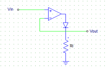

Shown below is the diagram of an ___
Shown below is the diagram of an ideal super diode. When the input voltage Vin is negative, then the output voltage Vout = ?
The output voltage Vout is 0 When the input voltage Vin is negative
Ideal Super Diode
A. Vout/Vin
B. Vin
C. 0
D. Vin * Rl
Answer: C
