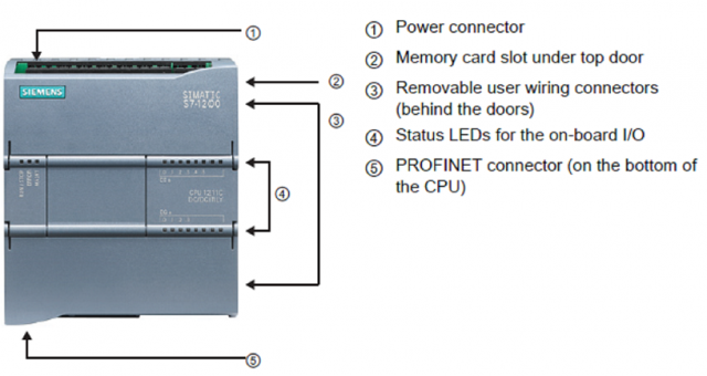

The CPU combines a microprocessor, an integrated power supply, input and output circuits, built-in PROFINET, high-speed motion control I/O, and on-board analog inputs in a compact housing to create a powerful controller.

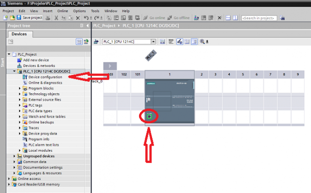

1- Start the program Tia Portal and go to “Device Configuration”.
2- Click the ethernet symbol. See the picture below.

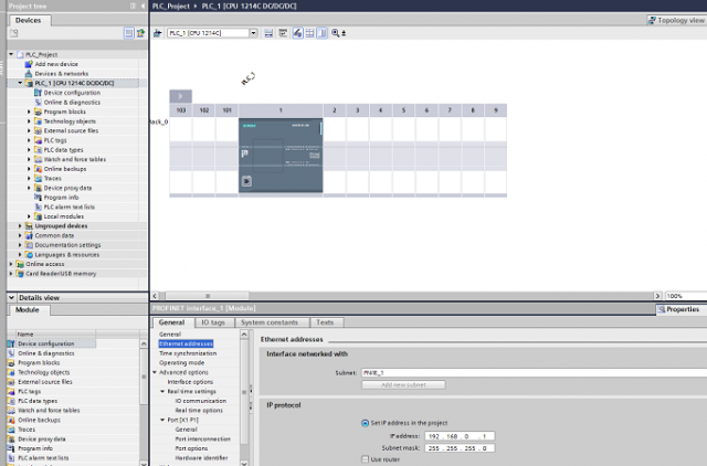

3-Change the IP adress.

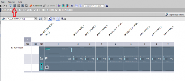

4-Save and compile the project and download the device.

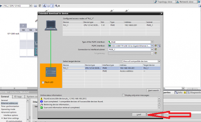

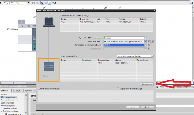

5-Start Search a device. It finds a accesible device.
6- After find accessible devices, Click the Load.
