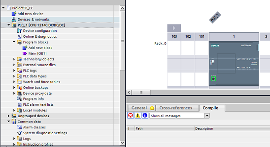

To create a function (FC) or afunction block (FB), follow these steps:

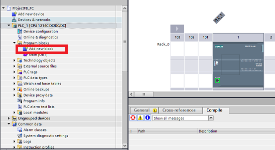

>>> Create New Project or use existing Project.
>>> Double-click the “Add new block” command.
>>> The "Add new block"dialog box opens.

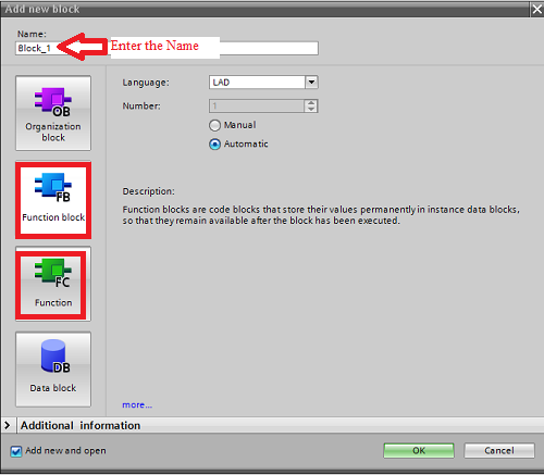

>>> Click the “Function block(FB)” or “Function (FC)” button.
>>> Enter a name for the new block.
>>> Enter the properties of the new block.

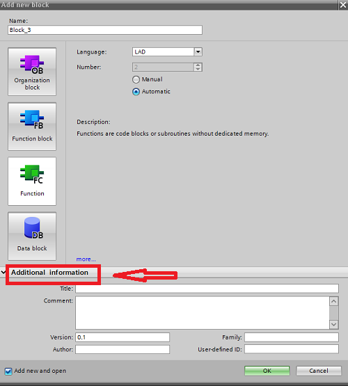

>>> Enter the properties of the new block.To enter additional properties for the new block, click “Additional information”.
An area with further input fields is displayed.
>>> Enter all the properties you require.
>>> Activate the “Add new and open” check box if the block does not open as soon as it is created.
>>> Confirm your entries with"OK".

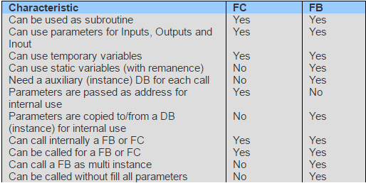

What is the Differences Between FB and FC Block?
Main difference is memory. Whilea FC uses the address of the given parameter to read and write directly inthen, a FB copy this parameters to/from a associated DB, and work internallyjust with the DB variables. The uses of an associated DB for each call (socalled Instance DB), open the possibility to store variables internally.
The table below shows the difference between FC and FB
Both FCs and FBs can hold parameters (IN, OUT, IN-OUT and TEMP), it allows the re-use of the blocks with different calling environments.
When you call an FB, you are required to generate an instance DB (Instance Data Block) that accompanies this particular call of an FB; this DB contains all the STATIC parameters of the FB, and these are available at any time by any other block in your program. this DB contains all the static parameters of the FB and can be used at any time by any other block in your program.
