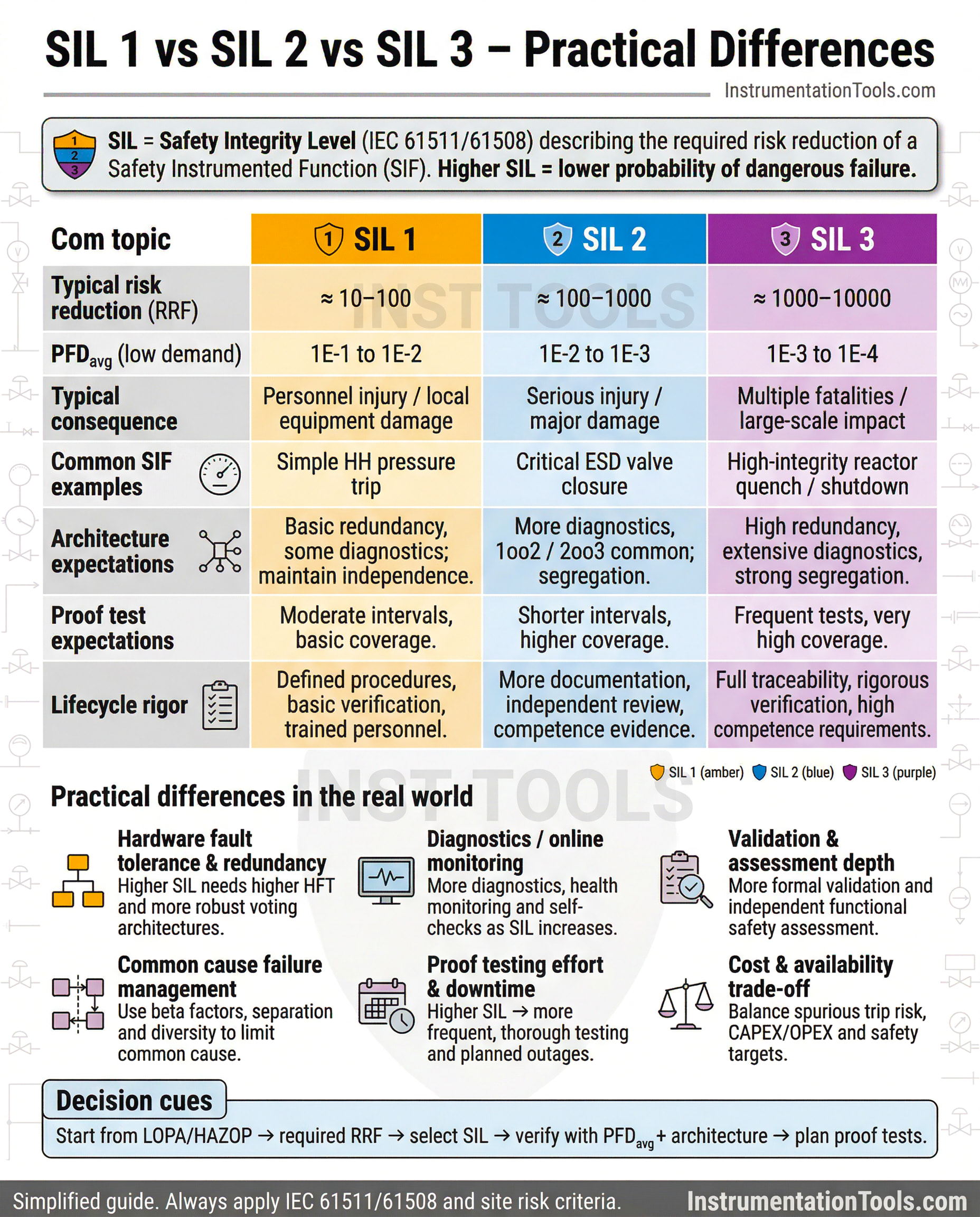

SIL 1 vs SIL 2 vs SIL 3
:shield: SIL 1 vs SIL 2 vs SIL 3 — Quick Comparison for Engineers
Not all safety systems are equal…
Choosing the right SIL level is about risk, not preference :backhand_index_pointing_down:
:gear: What is SIL?
:right_arrow: Safety Integrity Level (IEC 61508 / 61511)
:right_arrow: Measures how reliably a system performs a safety function
:right_arrow: Based on Probability of Failure on Demand (PFD)
SIL Levels Explained
:green_circle: SIL 1
:right_arrow: Basic risk reduction
:high_voltage: Lower safety requirement
:high_voltage: Simple safety logic
:high_voltage: Used for non-critical protection
:yellow_circle: SIL 2
:right_arrow: Medium risk reduction
:high_voltage: Higher reliability required
:high_voltage: Redundancy often used
:high_voltage: More validation & testing
:red_circle: SIL 3
:right_arrow: High risk reduction
:high_voltage: Very high reliability
:high_voltage: Redundant architecture (2oo3, etc.)
:high_voltage: Strict design, validation & maintenance
:bar_chart: Failure Probability (Low Demand Mode)
:green_circle: SIL 1 → 10⁻² to 10⁻¹
:yellow_circle: SIL 2 → 10⁻³ to 10⁻²
:red_circle: SIL 3 → 10⁻⁴ to 10⁻³
:backhand_index_pointing_right: Lower number = higher safety
:backhand_index_pointing_right::backhand_index_pointing_right: Watch Video:
:factory: Where they are used
:green_circle: SIL 1 → Utilities, basic process protection
:yellow_circle: SIL 2 → Process plants, standard safety loops
:red_circle: SIL 3 → Critical shutdown systems (ESD, HIPPS)
:bullseye: Key differences
:right_arrow: SIL 1 → Minimal protection
:right_arrow: SIL 2 → Balanced safety
:right_arrow: SIL 3 → Maximum industrial safety
:backhand_index_pointing_right: Higher SIL = Lower risk of failure
:backhand_index_pointing_right: But also = Higher cost & complexity
:warning: Important
:cross_mark: Don’t choose higher SIL blindly
:white_check_mark: Always based on risk assessment (LOPA / HAZOP)
#FunctionalSafety #SIL #ProcessSafety #Instrumentation Automation #ControlSystems #Engineering #IndustrialAutomation #IEC61511 #SafetyEngineering :rocket:
