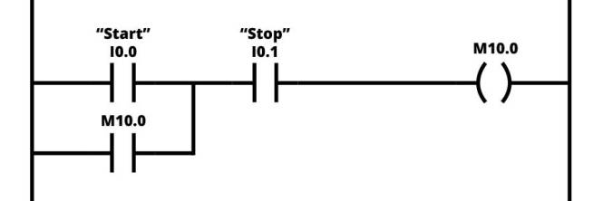

Simple Start/Stop Ladder Logic Relay
This is how the ladder diagram looks for a simple start/stop function. The function can be used to start and stop anything like a motor start/stop.
In this ladder logic example, there are two inputs.
  1. “Start button” or PLC input I0.0.
  2. “Stop button” or PLC input I0.1.
The start button will activate the relay, or ladder logic relay M10.0. When the start button is released, the relay will still be activated, because of the latch in ladder rung 2. This latching will be broken when the stop button is activated.
You might wonder why the stop button in this example is normally open. And the reason for that, is that y ou should use normally closed as stop button, to avoid dangerous situations under failure.*

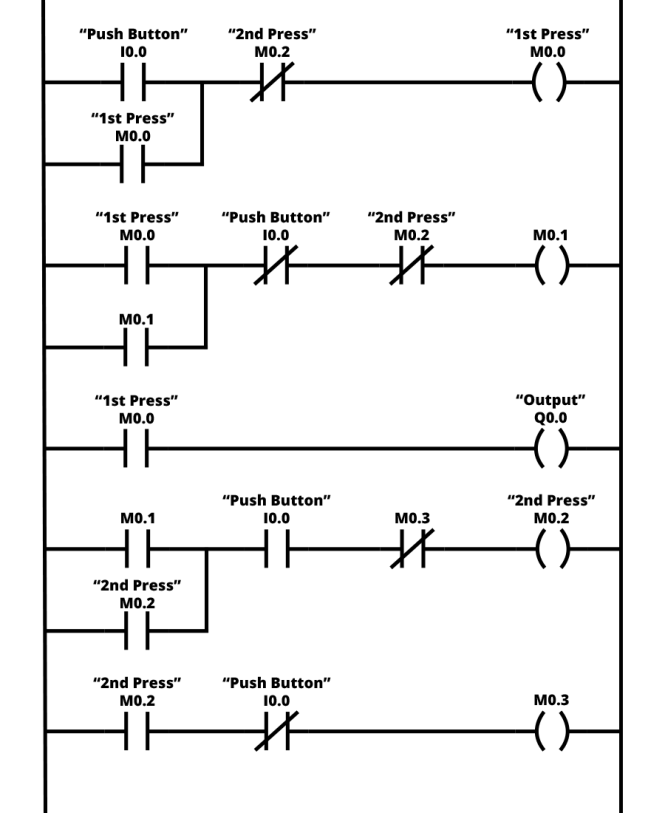

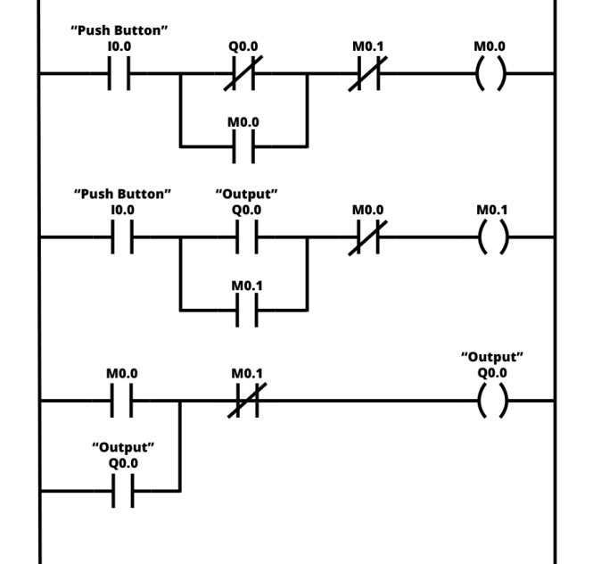

This function is also called push on push off logic sometimes even flip-flop or toggle function . It is the same function as the on/off button on your computer or mobile phone. When you push the button the first time, the output will be activated. Now, when you push the button for the second time, the output will deactivate and turn off. The single push button has two functions: on and off.
Push on push off logic can be done in several ways. It can be done by using ladder logic and boolean logic instructions or it can be done with a counter. It can even be done with PLC rising edge and falling edge triggers or with shift registers.
Here is the example using boolean logic instructions only (complicated version):
But… there is a faster way to make the same toggle function with a single push button:
The example is from Mayur Haldankar’s blog about PLC programming and DSP (digital signal processing). He even has examples of DSP programs written in C++.
In his example, he uses 3 (4) rungs only to make the toggle function of a push button (simple version):
