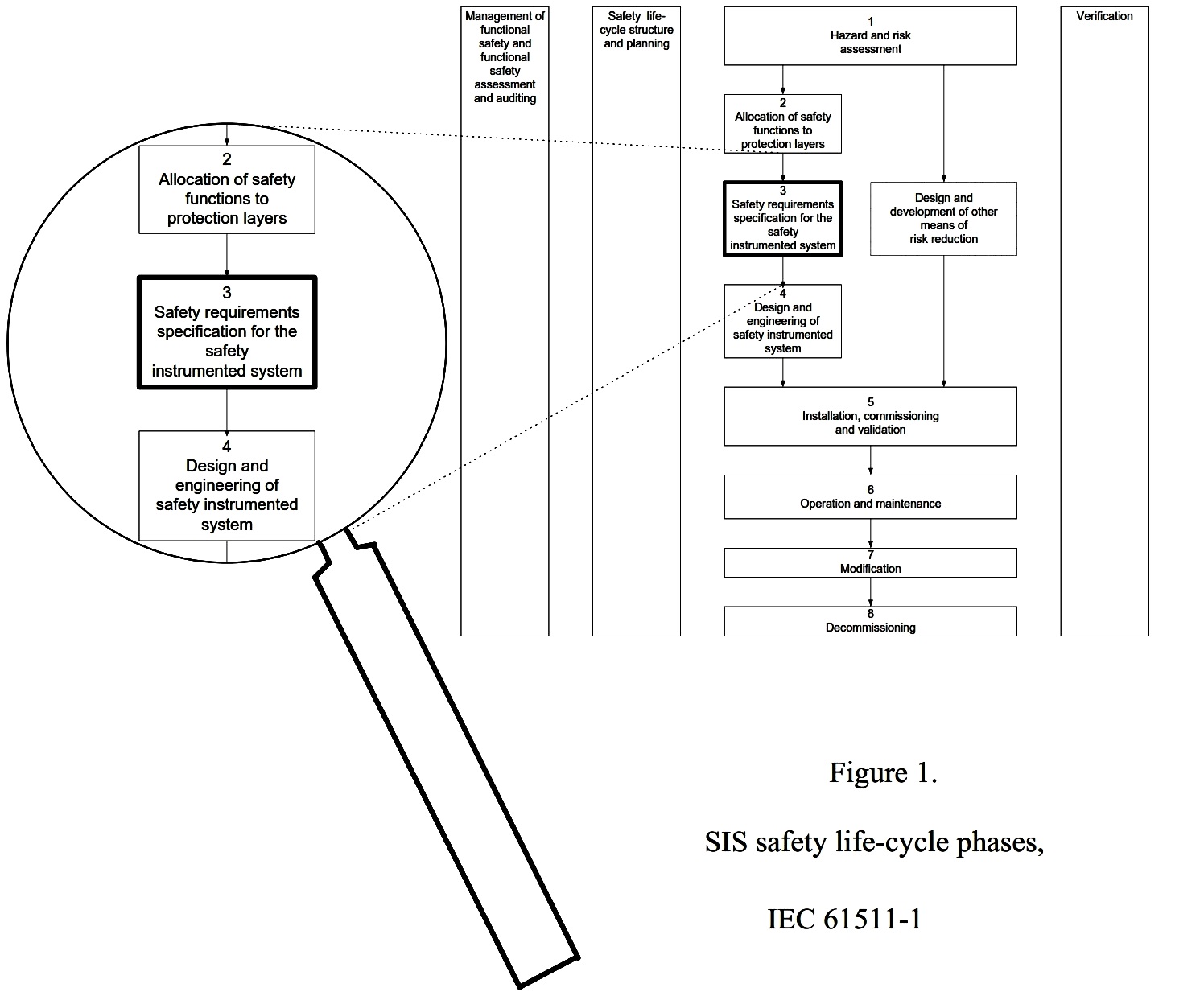

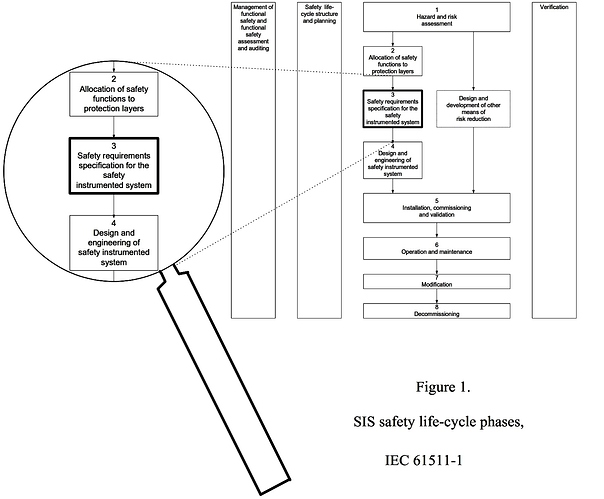

The requirements need to be documented during the safety planning. The SRS (3) is created after the hazard and risk analysis (1) and the allocation of safety functions to protective layers (2) in the safety life cycle according to IEC 61511-1. See figure 1.
The safety requirements shall be derived from the allocation of safety instrumented functions.
