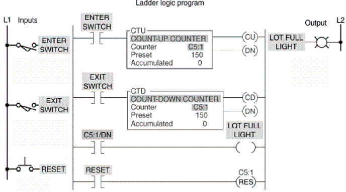

Suppose the accumulated count is 60 before the Enter switch input is ___
Suppose the accumulated count is 60 before the Enter switch input is actuated 15 times and the Exit switch input is actuated 5 times.
After this operational sequence, the accumulated count would be:
103 Ladder Logic Diagram
A. 80.
B. 65.
C. 75.
D. 70.
Answer: D
