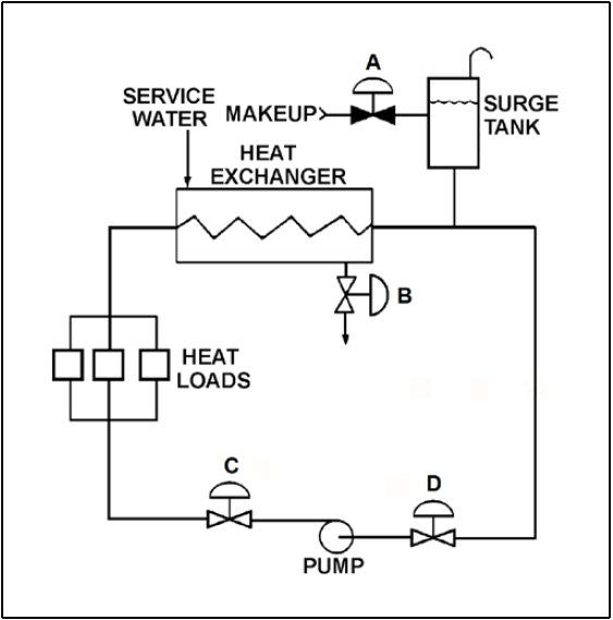

The available net positive suction head for the centrifugal pump will be decreased by ___
Refer to the drawing of a cooling water system (see figure below).
The available net positive suction head for the centrifugal pump will be decreased by…
A. increasing surge tank level by 5 percent.
B. throttling heat exchanger service water valve B more open.
C. throttling pump discharge valve C more closed.
D. increasing the heat loads on the cooling water system.
Answer: D
