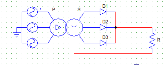

The diodes D1, D2 & D3 are connected to ___
In the below shown diode rectifier circuit,
5.Diode Rectifier Circuit
The diodes D1, D2 & D3 are connected to phases R,Y and B receptively as shown
The phase sequence is R-Y-B.
The diode D3 conducts from
A. 0 to 270 degrees
B. 270 to 390 degrees
C. 270 to 450 degrees
D. 270 to 360 degrees
Answer: C
