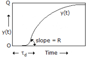

The experimental response of the controlled variable y(t) for a step change of magnitude P in the manipulated variable x(t) is shown below
The appropriate transfer function of the process is
A. ![]()
B. ![]()
C. ![]()
D. ![]()
Answer: C
