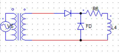

For the below given circuit,
With Vs = Vm sin ωt (secondary side).
The expression for the average voltage is
A. Vm
B. Vm/2π
C. Vm/π
D. Vm/2
Answer: C
