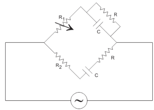

The given figure shows wein bridge connection for ___
The given figure shows wein bridge connection for frequency measurement.
Bridge Converter
C and R are variables and gang together.
For balanced condition the expression for frequency is f = 1/2πCR when
A. R1 = R2.
B. R1 = 2R2.
C. R1 = R2/2.
D. R1 = 3R2.
Answer: C
