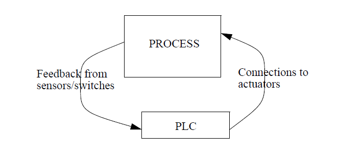

When a process is controlled by a PLC it uses inputs from sensors to make decisions and update outputs to drive actuators, as shown in below Figure. The process is a real process that will change over time.
PLC Process
Actuators will drive the system to new states (or modes of operation). This means that the controller is limited by the sensors available, if an input is not available, the controller will have no way to detect a condition.
The control loop is a continuous cycle of the PLC reading inputs, solving the ladder logic, and then changing the outputs. Like any computer this does not happen instantly.
