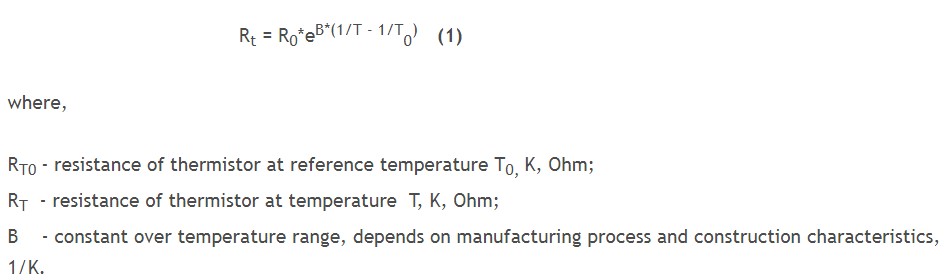

These oxides are compressed into the desired shape from the specially formulated powder. After that, the oxides are heat-treated to recrystallise them. As the result of this treatment the ceramic body becomes dense. The leadwires are then attached to this sensor for maintaining electrical contact.The following relationship applies to most thermistors:

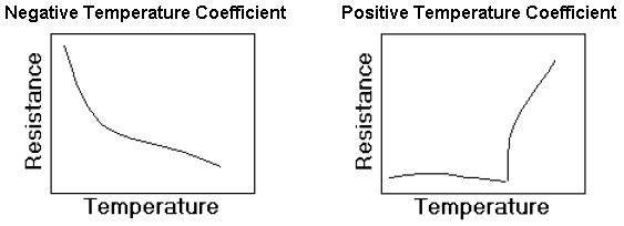

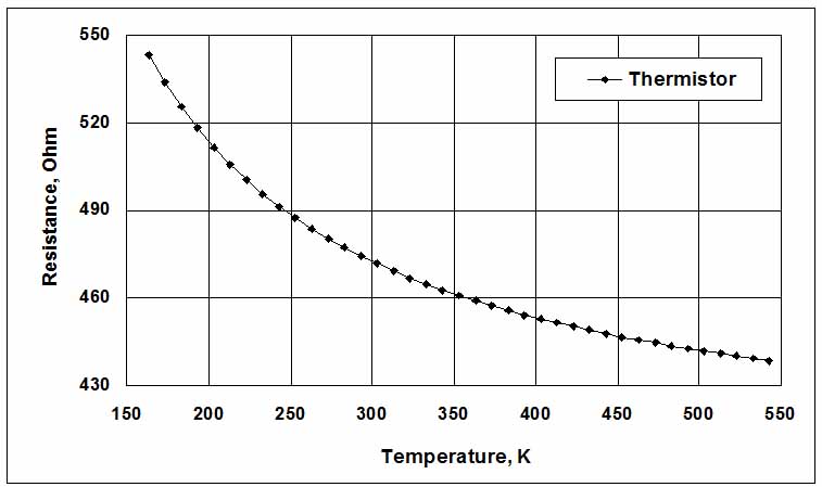

Fig. shows relationship between temperature and resistance for a thermistor.Thermistors have negative thermal coefficient of electrical resistance. It means that when temperature increases the electrical resistance of thermistor decreases. They have greater resistance change (this is an advantage) compared with RTD in a given temperature range. For example, if we compare what change in resistance will be caused by variation of temperature in 1 °C for Platinum and Copper RTD and for thermistor (see Fig. 2) in the temperature range from 273.15 to 423.15 K (ie, from 0 to 150 °C), we will obtain the following values:
• for platinum RTD - 0.38, Ohm / ̊C;
• for copper RTD - 0.04, Ohm / ̊C;
• for thermistor - 0.65, Ohm / ̊C;
Figure 2. Thermistor resistance vs temperature curve.
