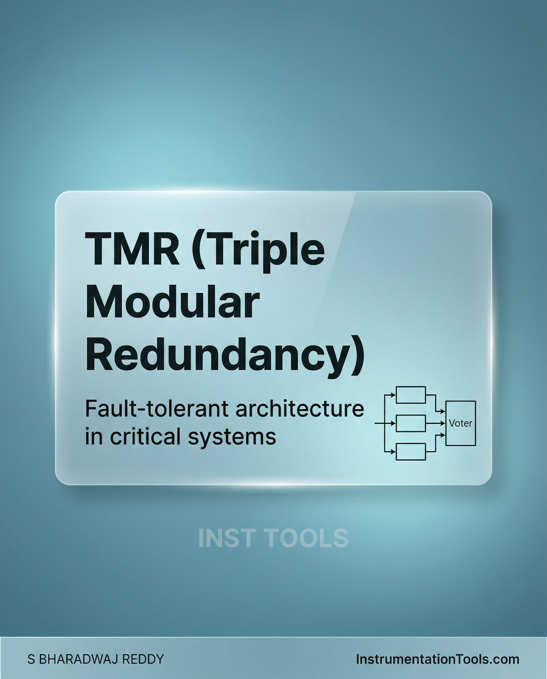

TMR (Triple Modular Redundancy) Explained
:shield: TMR (Triple Modular Redundancy) in Safety Systems
When a single controller failure cannot be tolerated, industries use TMR architecture to keep systems safe and reliable.
Here’s the idea in simple terms :backhand_index_pointing_down:
:gear: What is TMR?
:right_arrow: TMR = Triple Modular Redundancy

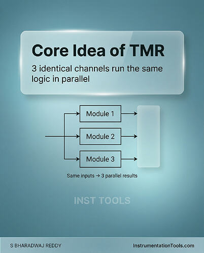

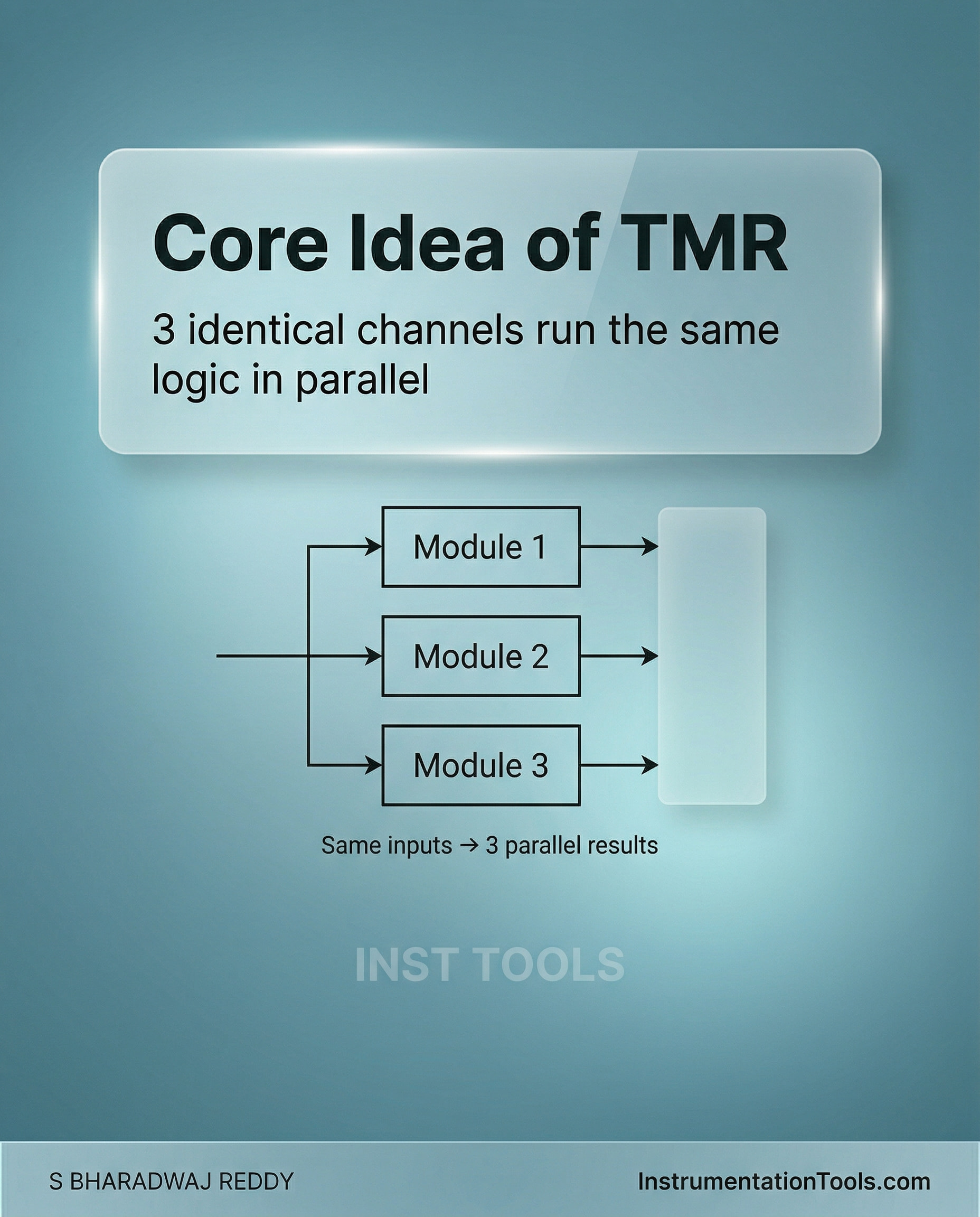

The system uses three identical controllers running the same logic simultaneously.

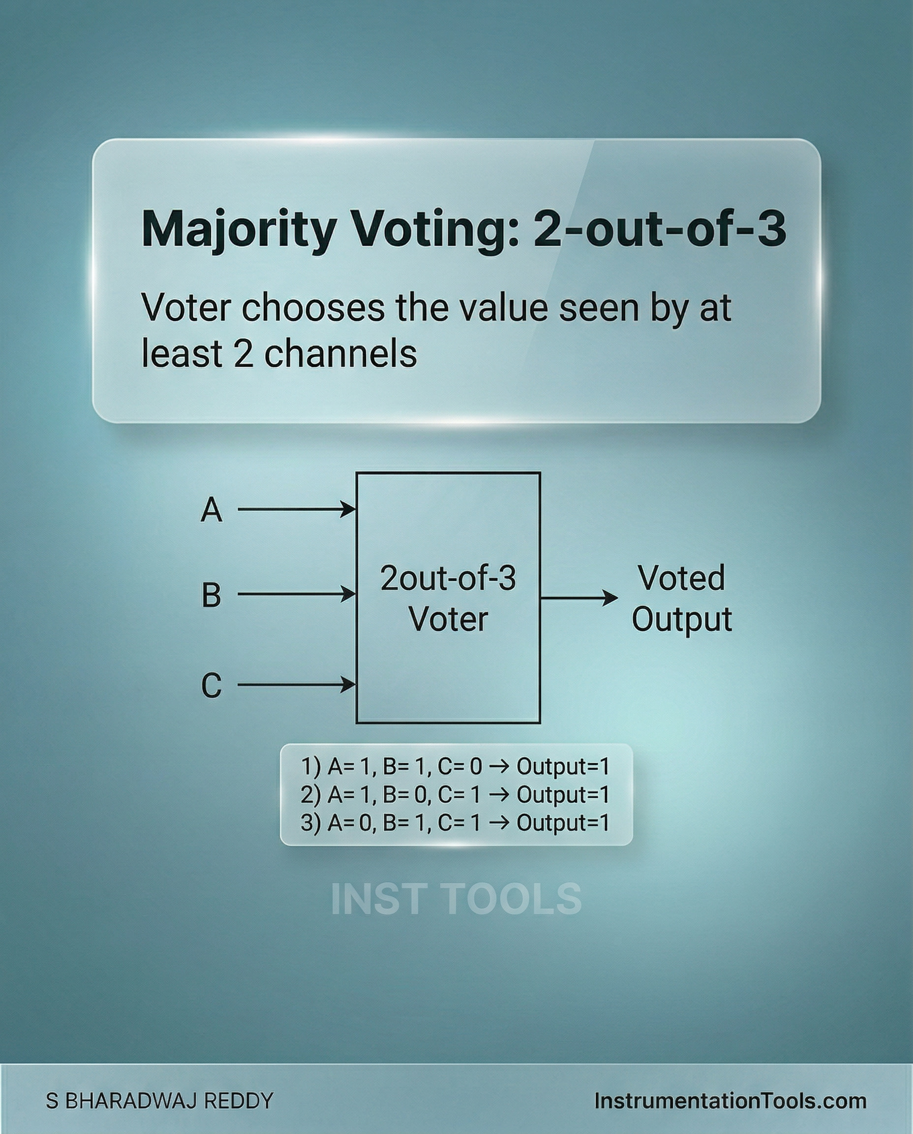

The final output is determined using majority voting (2 out of 3).
:brain: How TMR works
Three controllers process the same input signals.
:small_blue_diamond: Controller A
:small_blue_diamond: Controller B
:small_blue_diamond: Controller C
The system compares the outputs.
:right_arrow: If two outputs match, that becomes the final action.

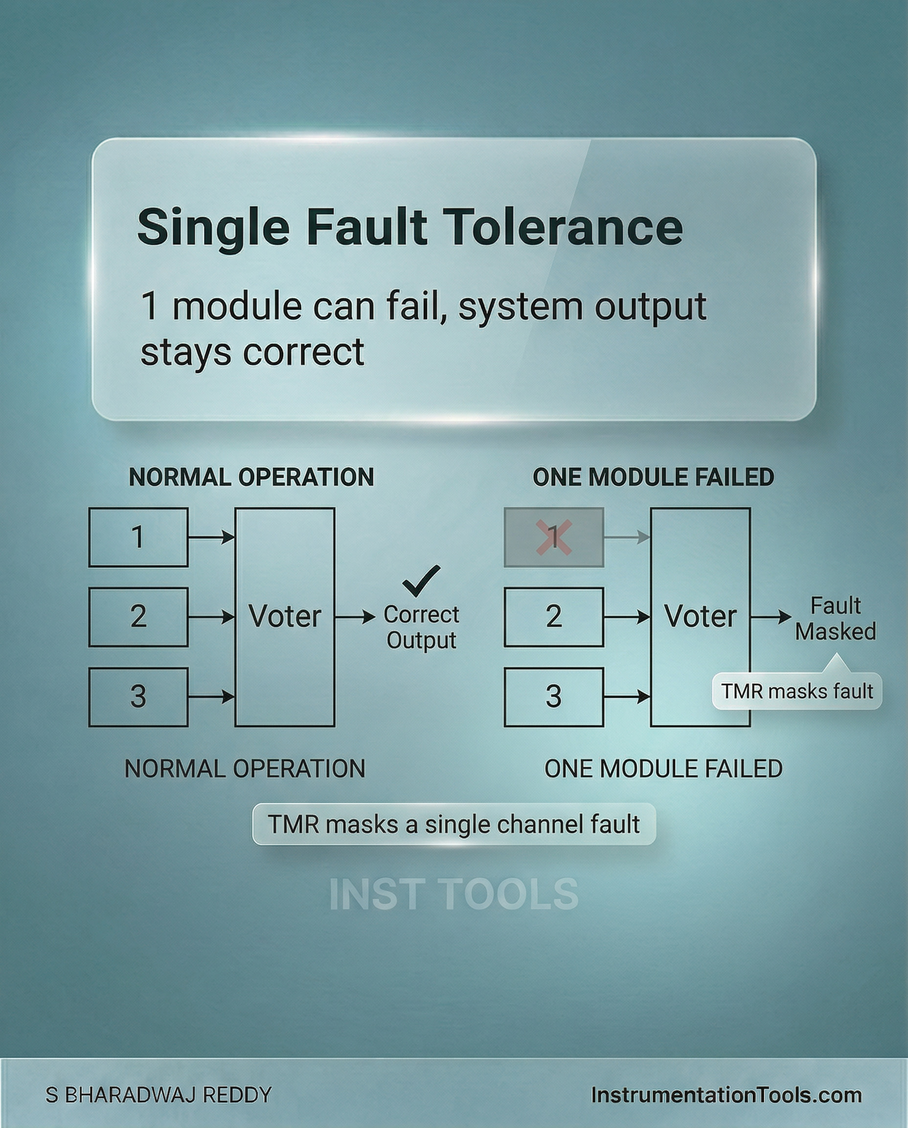

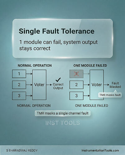

:police_car_light: Example
Controller A → Trip
Controller B → Trip
Controller C → No Trip
:white_check_mark: Majority decision = Trip

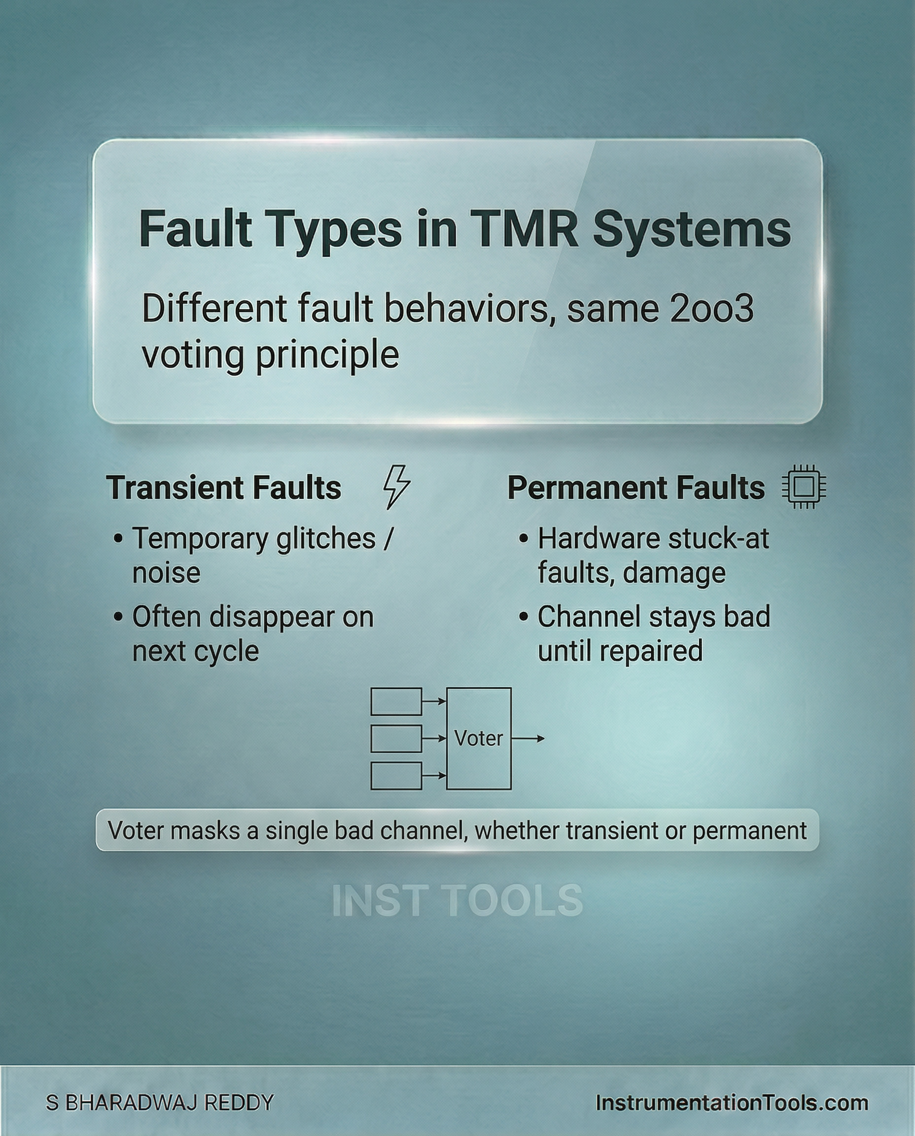

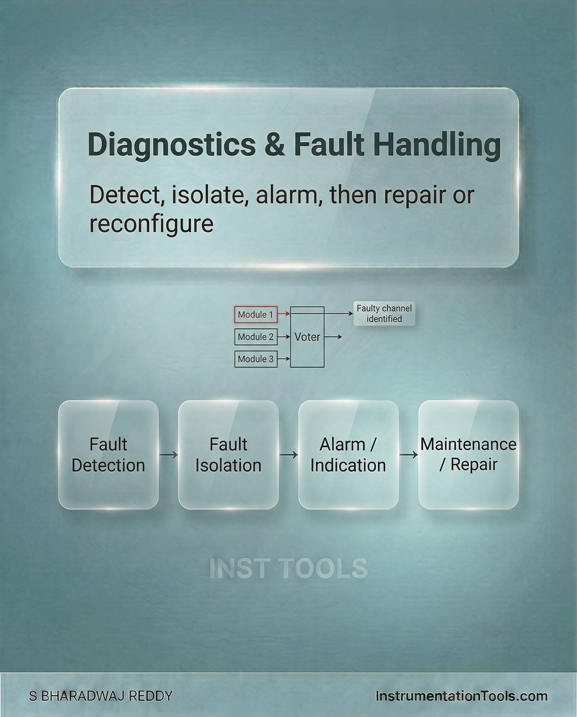

The faulty controller is ignored.
:magnifying_glass_tilted_left: Why TMR is powerful
:high_voltage: Tolerates one controller failure
:high_voltage: Eliminates single point of failure
:high_voltage: Maintains system operation
:high_voltage: Increases system reliability and availability
