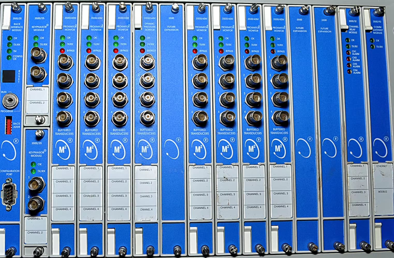

Answer:
A typical 3500 rack contains:
  • Rack and Backplane – the chassis where all modules plug in.
  • Power Supply Module(s) – redundant AC/DC power for the rack.
  • TDI (3500/22M Transducer Interface Module) – central communication and configuration module.
  • Monitoring Modules – vibration, position, speed, temperature, etc.
  • Relay Modules – for alarm/trip outputs.
  • I/O Modules – terminal strips and connectors for wiring sensors and outputs.
The backplane interconnects all modules, distributes power, and carries internal data and OK/relay bus signals.
