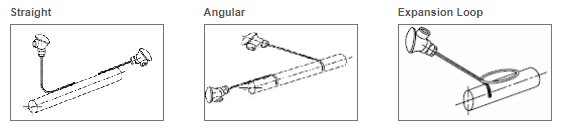

Tube Temperature Type Thermocouples are ideal for the reliable measurement of tube wall temperatures in fired heaters which is important for prolonging tube life and ensuring safe and efficient operation.
The Tube temperature Thermocouple is designed to be responsive to tube wall temperature by placing the thermo-junction in fused contact with the tube wall thus providing a direct and total metallic heat transfer path from the sheath to the Tube wall.
Such type of thermocouples provides better accuracy, superior reliability, improved longevity and ease of installation .
Tube or Skin type thermocouples can be designed and factory formed to suit nearly any installation or application based on the clients requirement.
