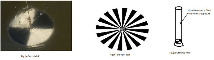

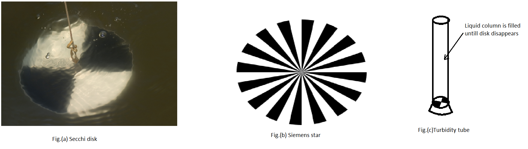

Secchi disc :
Secchi is opaque circular disc divided into 4 quadrants, alternate quadrants painted black.
Disc is attached to cord & lowered until it disappears.
The disk is lowered a few more cm and then is slowly raised again until it reappears. This second reading of depth is also noted.
The average of these two readings is taken, corresponding depth is called Secchi dept.
Higher Secchi dept, more clear water is.
Turbidity tube:
- It is an alternative to Secchi disk. The length of water column makes pattern disappear is required Secchi depth.
Note:A Siemens star is a device used to test the resolution of optical instruments, printers and displays. It consists of a pattern of bright"spokes" on a dark background that radiate from a common center and become wider as they get further from it. It is useful tool for comparing two printers’ resolutions.
Advantage:
Inexpensive
Easy and reliable
Disadvantage:
Accuracy depends on eyesight of measure r.
Quality of water changes with session
Need to take multiple reading to improve accuracy.
