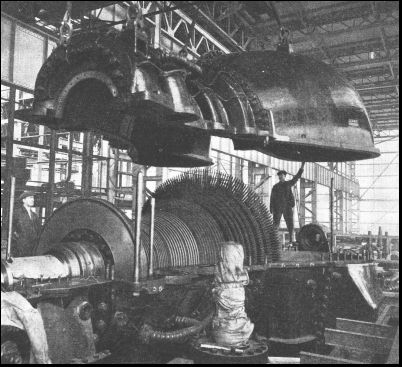

The interior of a turbine comprises several sets of blades, or buckets as they are more commonly referred to. One set of stationary blades is connected to the casing and one set of rotating blades is connected to the shaft. The sets intermesh with certain minimum clearances, with the size and configuration of sets varying to efficiently exploit the expansion of steam at each stage.

When warming up a steam turbine for use, the main steam stop valves (after the boiler) have a bypass line to allow superheated steam to slowly bypass the valve and proceed to heat up the lines in the system along with the steam turbine. Also, a turning gear is engaged when there is no steam to the turbine to slowly rotate the turbine to ensure even heating to prevent uneven expansion. After first rotating the turbine by the turning gear, allowing time for the rotor to assume a straight plane (no bowing), then the turning gear is disengaged and steam is admitted to the turbine, first to the astern blades then to the ahead blades slowly rotating the turbine at 10–15 RPM (0.17–0.25 Hz) to slowly warm the turbine.
Any imbalance of the rotor can lead to vibration, which in extreme cases can lead to a blade breaking away from the rotor at high velocity and being ejected directly through the casing. To minimize risk it is essential that the turbine be very well balanced and turned with dry steam - that is, superheated steam with a minimal liquid water content. If water gets into the steam and is blasted onto the blades (moisture carry over), rapid impingement and erosion of the blades can occur leading to imbalance and catastrophic failure. Also, water entering the blades will result in the destruction of the thrust bearing for the turbine shaft. To prevent this, along with controls and baffles in the boilers to ensure high quality steam, condensate drains are installed in the steam piping leading to the turbine. Modern designs are sufficiently refined that problems with turbines are rare and maintenance requirements are relatively small.
