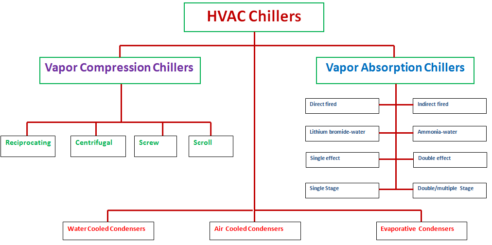

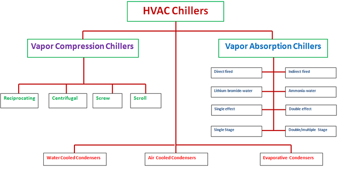

Hvac water chillers are classified primarily on the basis of cycle on which they work.
- Vapor compression chillers or compression chillers or electric chillers
- Vapor absorption chillers or absorption chillers or ammonia chillers or lithium bromide chillers
Vapor compression chillers are further classified on following basis.
- Type of compressor i.e reciprocating compressor,rotory compressor or screw compressor type vapor compressor chillers
- Type of condenser i.e air cooled condenser or air cooled chillers OR water cooled condensers or water cooled chillers
While Vapor absorption chillers are further classified as following:
- Direct fired absorption chillers (Natural gas, Diesel or Kerosene Oil Operated)
- Indirect fired absorption chillers
