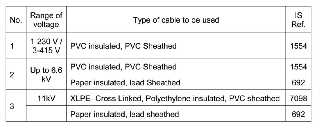

The below table gives information on cables for different voltages.
Source: CPHEEO, 1993
