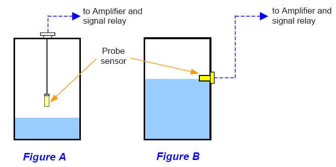

Ultrasonic detectors with single sensor:
A typical single-sensor liquid level indicator is shown in figure A and Figure B
