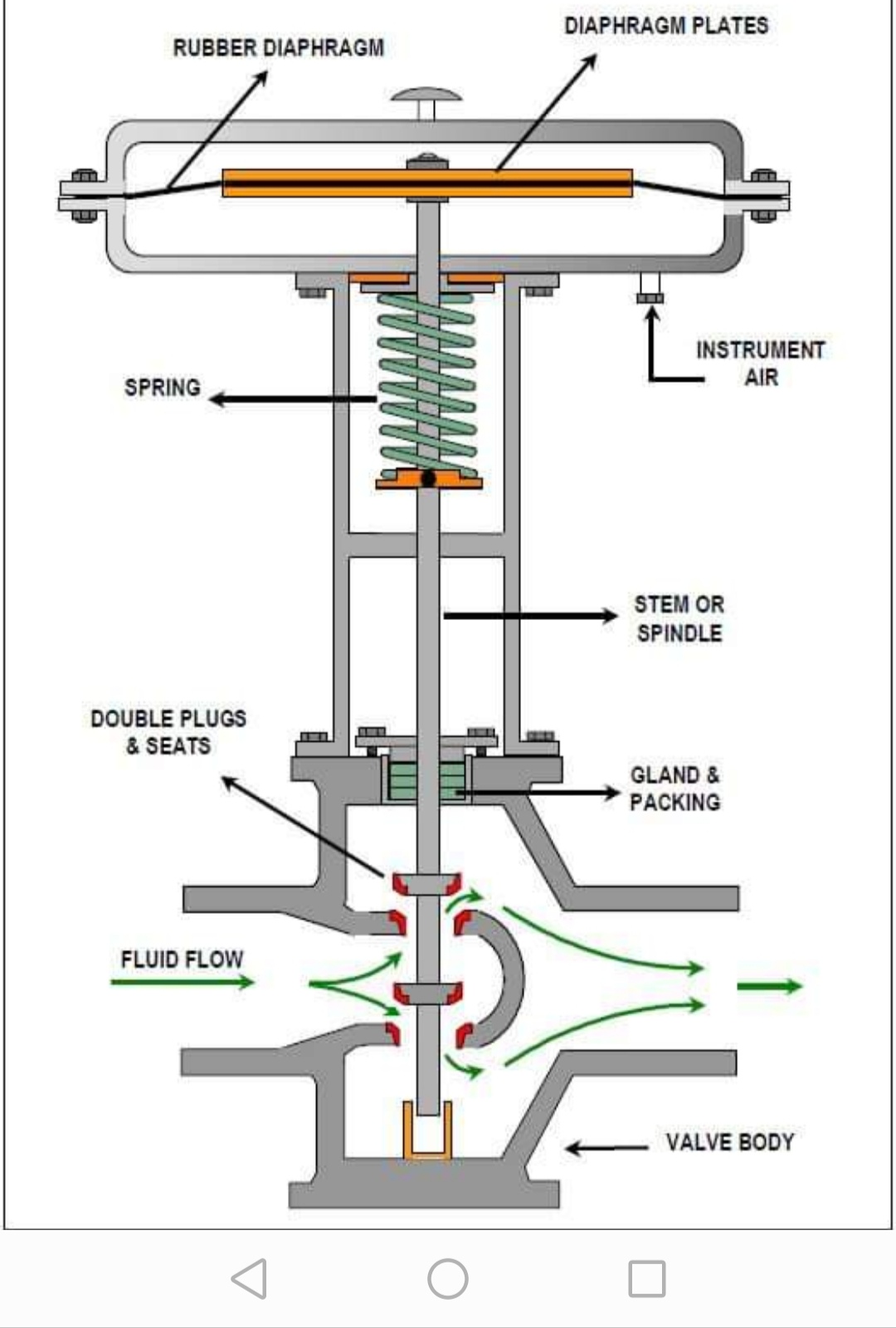

A) A Diaphragm
Here, the valve is operated by an air powered diaphragm. These are called ‘Pneumatic Control Valves’.
The air powered actuator can also take the form of a ‘Piston’ rather than a diaphragm. The operation of the valve, depending on requirements, may be ‘Air to Open’ (AO) or ‘Air to Close’ (AC).
