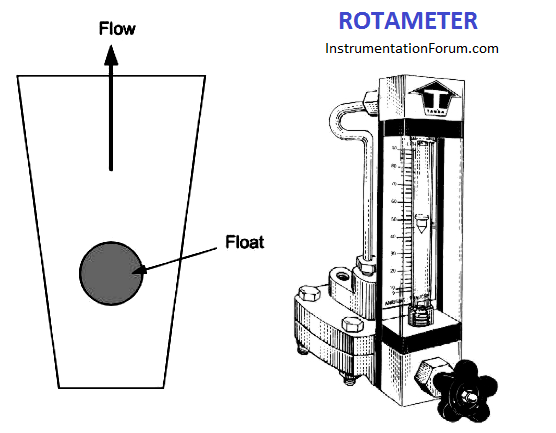

Rotameter
The rotameter is a variable area meter that employs a vertical tube of varying diameter, with an object inserted in it. This object is known as the float. This type meter is used only in a vertical position, as gravity is a primary force involved in the calibration the device.
The float is moved vertically in the variable diameter tube by a combination of buoyancy forces and flow pressure forces. The flow pressure forces are created by the fluid try in move around the float, by using the gap between the float and the sides of the tube.
As the forces move the float up the tube, the widening gap between the tube and the float allow these forces to be reduced, and gravity tends to force the float back down the tube toward the bottom.
At the equilibrium point for a given flow, the forces of flow and buoyancy in the vertical direction are balanced the mass of the float being pulled down by gravity.
