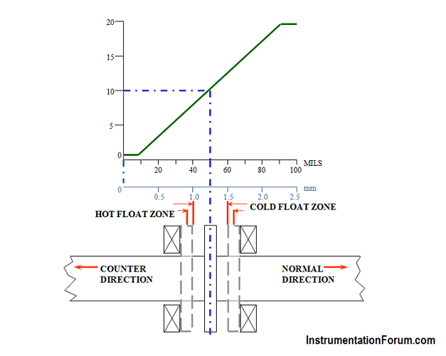

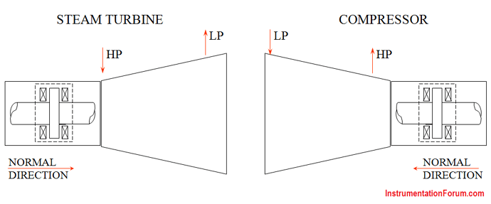

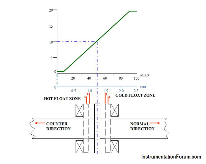

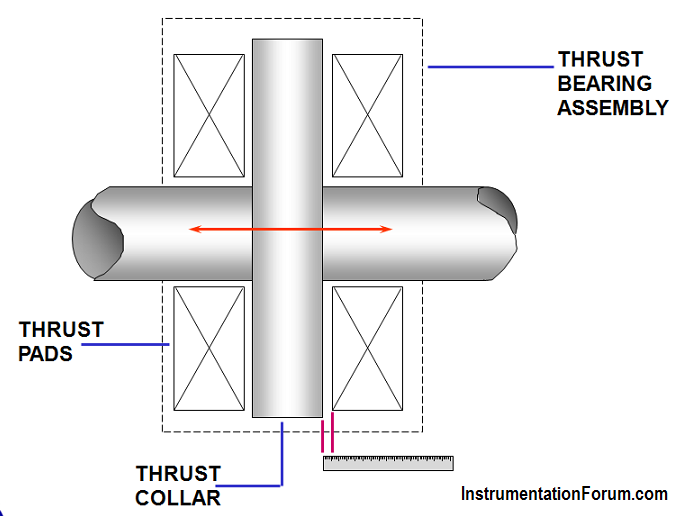

Axial Position
Thrust Position
Measurement of the position of the thrust collar in the thrust bearing assembly and how much bearing material may be used up.
The probes are mounted on the thrust bearing observing the movement of the rotor position within the thrust bearing.

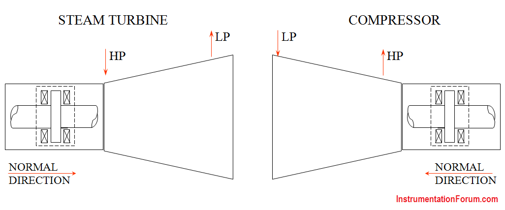

Rotor Position

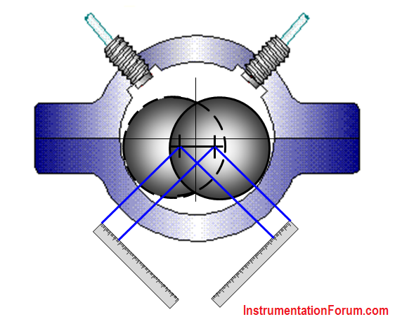

Radial Position:
Proximity Probes are used in The X-Y configuration to measure radial vibration, the dc signal from the transducer can be used to indicate the radial position of the rotor within the bearing

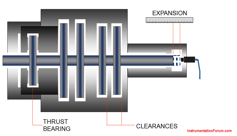

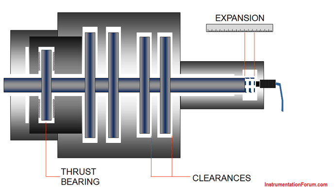

Differential Expansion

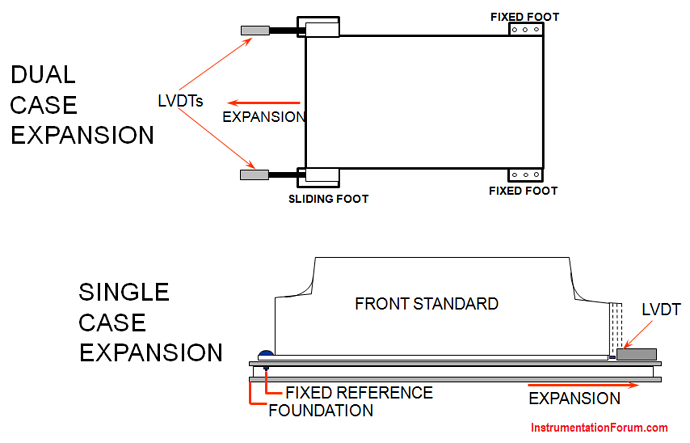

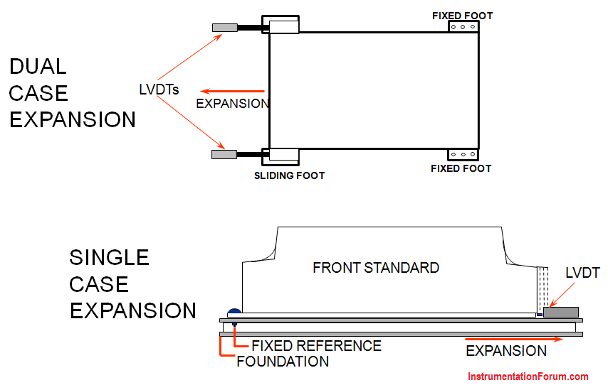

Case Expansion

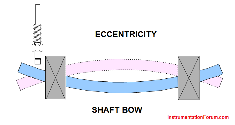

Eccentricity
