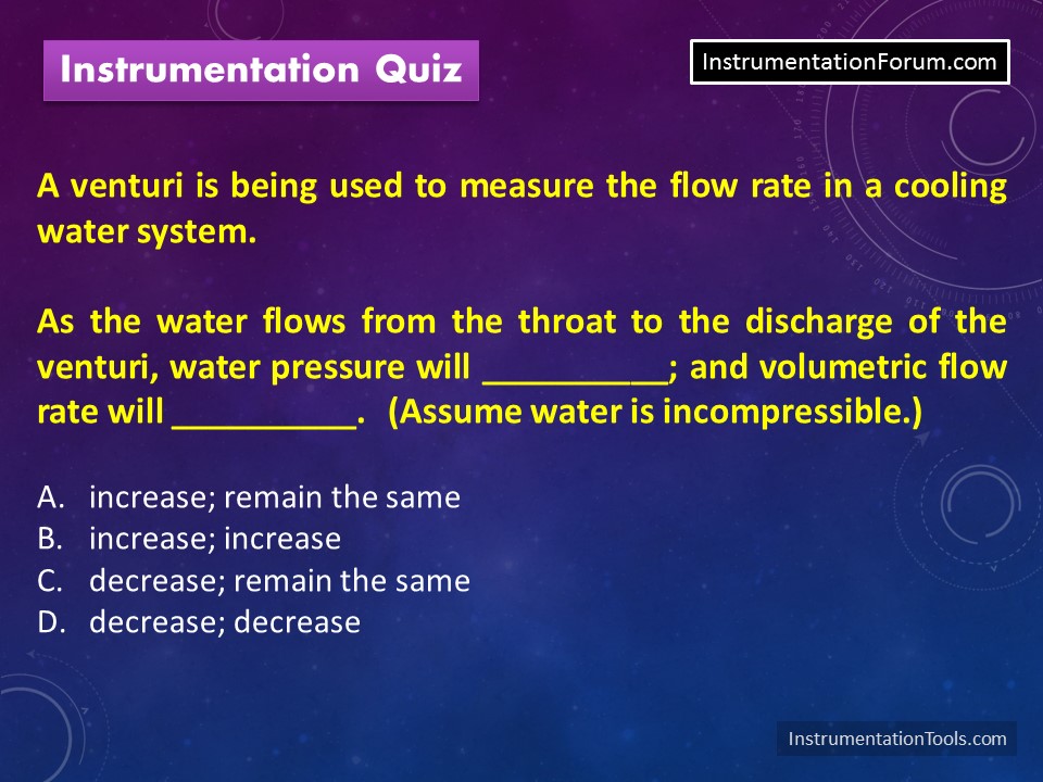

A venturi is being used to measure the flow rate in a cooling water system. As the water flows from the throat to the discharge of the venturi, water pressure will __________; and volumetric flow rate will __________. (Assume water is incompressible.)
A. increase; remain the same
B. increase; increase
C. decrease; remain the same
D. decrease; decrease
ANSWER: A.
