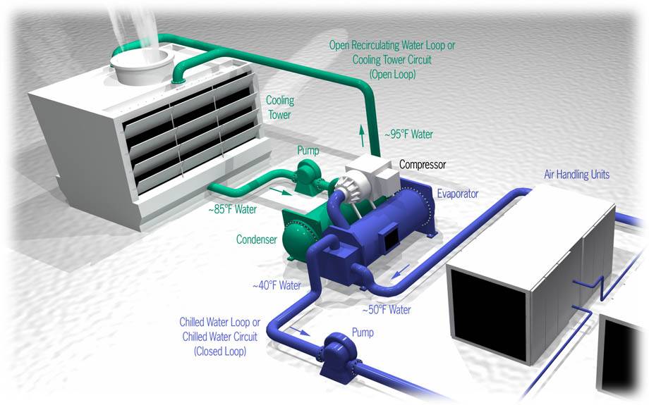

HVAC system working principle is explained as below.
In the background of HVAC system ,an HVAC water chiller produces chilled water which is then circulated throughout the building or space upto cooling coils in air handling units.Blowers move air on cooling coils which is then distributed into various portions of space or building for providing comfort or preserving goods/items as per HVAC design.
Air is distributed through supply ducts and return air is collected in air handling units with the help of return ducts.Chilled water and cooling water pumps provide energy to keep the chilled and cooling water moving.
HVAC Valves are also installed at various points in piping to ease the maintenance of HVAC system or for the sake of system control.Heating of air may be done with the help of HVAC heat pump ,hot water generator or simply by furnace.Some industrial chillers also serve as heaters in winter season.Heating coils take the place of cooling coils in case of heating mode.
