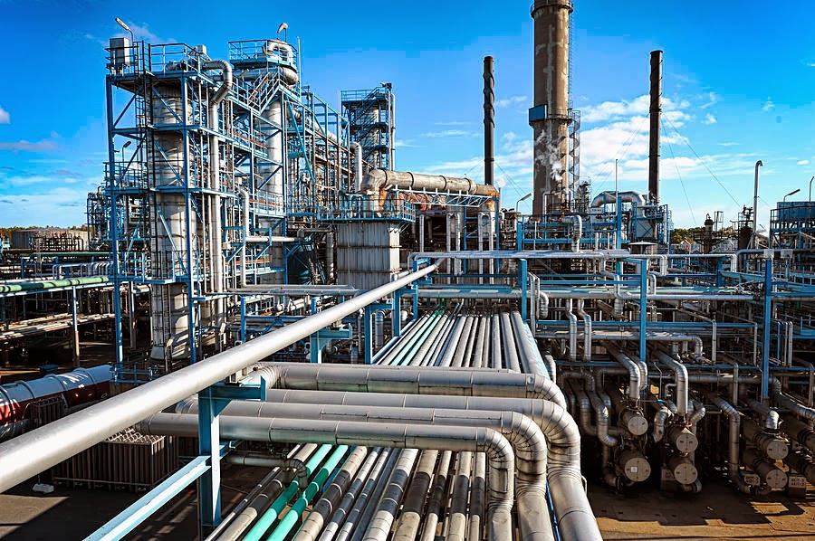

Inside a maze of silver towers and pipes is a fascinating factory that changes hydrocarbon molecules to make gasoline.
A refinery is a factory. Just as a paper mill turns lumber into legal pads or a glass works turns silica into stemware, a refinery takes a raw material–crude oil-- and transforms it into gasoline and hundreds of other useful products. A typical large refinery costs billions of dollars to build and millions more to maintain and upgrade. It runs around the clock 365 days a year, employs between 1,000 and 2,000 people and occupies as much land as several hundred football fields. It’s so big and sprawling, in fact, that workers ride bicycles from one station to another.

Today, some refineries can turn more than half of every 42-gallon barrel of crude oil into gasoline. That’s a remarkable technological improvement from 70 years ago, when only 11 gallons of gasoline could be produced. How does this transformation take place? Essentially, refining breaks crude oil down into its various components, which then are selectively reconfigured into new products. This process takes place inside a maze of hardware that one observer has likened to “a metal spaghetti factory.” Employees regulate refinery operations from within highly automated control rooms. Because so much activity happens out of sight, refineries are surprisingly quiet places. The only sound most visitors hear is the constant, low hum of heavy equipment.

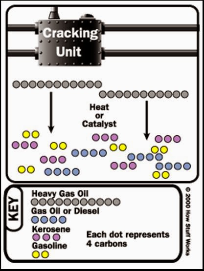

The most widely used conversion method is called cracking because it uses heat and pressure to “crack” heavy hydrocarbon molecules into lighter ones. A cracking unit consists of one or more tall, thick-walled, bullet-shaped reactors and a network of furnaces, heat ex-changers and other vessels.
Fluid catalytic cracking, or “cat cracking,” is the basic gasoline-making process. Using intense heat (about 1,000 degrees Fahrenheit), low pressure and a powdered catalyst (a substance that accelerates chemical reactions), the cat cracker can convert most relatively heavy fractions into smaller gasoline molecules.
Hydrocracking applies the same principles but uses a different catalyst, slightly lower temperatures, much greater pressure and hydrogen to obtain chemical reactions. Although not all refineries employ hydrocracking, some of industry leader in using this technology to cost-effectively convert medium- to heavyweight gas oils into high-value streams. The company’s patented hydrocracking process, which takes place in the Isocracker unit, produces mostly gasoline and jet fuel.Some refineries also have cokers, which use heat and moderate pressure to turn residuum into lighter products and a hard, coal like substance that is used as an industrial fuel. Cokers are among the more peculiar-looking refinery structures. They resemble a series of giant drums with metal derricks on top.
