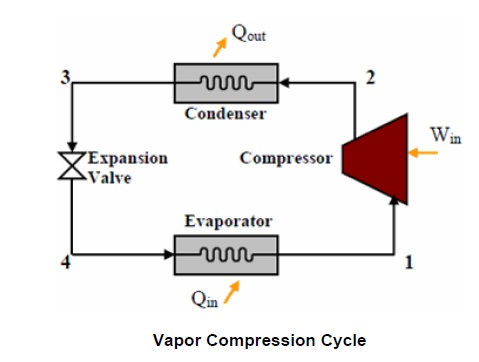

The vapor compression cycle basically consists of an evaporator, condenser, throttling valve, and a compressor. Figure below illustrates the components and flow arrangement for it.
In the shown cycle, refrigerant in the form of a cool mixture of liquid and vapor centers the evaporator at low pressure (4). Then using relatively warm air or water, the liquid refrigerant will boil. The resulted vapor (1) is pumped by the compressor, which raises refrigerant vapor pressure and temperature.
This hot refrigerant vapor at high pressure (2) enters the condenser, where heat is released to a lower temperature ambient air or water, and the refrigerant vapor turns into a liquid, then passes to the expansion device (3), where the pressure of the refrigerant is reduced to the pressure of the evaporator, and a little amount of the refrigerant boils, cooling the staying liquid refrigerant to the wanted evaporator temperature. Then mixture of the cool liquid and vapor refrigerant (4) passes to the evaporator and repeats the cycle.

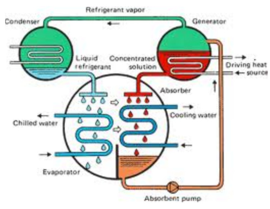

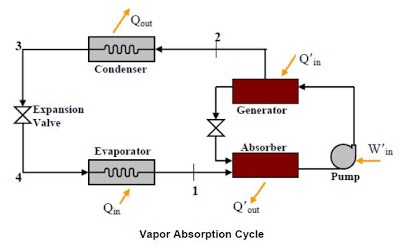

The absorption cycle is similar to the vapor compression cycle in many components, but it uses a different compression method and different refrigerants unlike the vapor compression cycle.The absorption cycle replaces the compressor with a generator, an absorber, and pump.
As we said, a refrigerant enters the evaporator at low pressure in the form of a cool mixture of vapor and liquid (4). Then the liquid refrigerant boils due to heat transferred from a relatively warm water to it. The function of the absorber is similar the suction side of the compressor, which the vapor refrigerant enters it and mixes with the absorbent.
The pump make the same process of the compressor, which pumps the mixture of absorbent and refrigerant to the generator at high pressure. In the generator, the refrigerant vapor is extracted and delivered to the condenser (2), where the refrigerant vapor condenses into a liquid due to heat transferred from it to lower temperature water.
Then the liquid refrigerant passes to the expansion device (3), where the pressure of the refrigerant is reduced to the pressure of the evaporator, and a little amount of the refrigerant boils, cooling the staying liquid refrigerant to the wanted evaporator temperature. Then mixture of the cool liquid and vapor refrigerant (4) passes to the evaporator and repeats the cycle.

Vapor compression cycle uses compressor, but the absorption chiller system uses a liquid pump to produce the pressure difference between condenser and evaporator. A liquid pump is much easier in work and cheaper than compressing a gas, so that it takes less work input. However, the absorption chiller system replaces the compressor work input with a heat pump in the generator.
