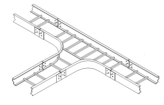

Below picture shows cable ladder picture.
