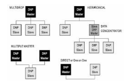

It plays a crucial role in SCADA systems. It is used by SCADA Master Stations or Control Centers, Remote Terminal Units, and Intelligent Electronic Devices. It is primarily used for communications between a master station and IEDs or RTU’s.
DNP3 supports multiple-slave, peer-to-peer and multiple-master communications. It supports the operational modes of polled and quiescent operation. The latter is also referred to as reporting by exception.
Overview of theDNP3 Protocol
