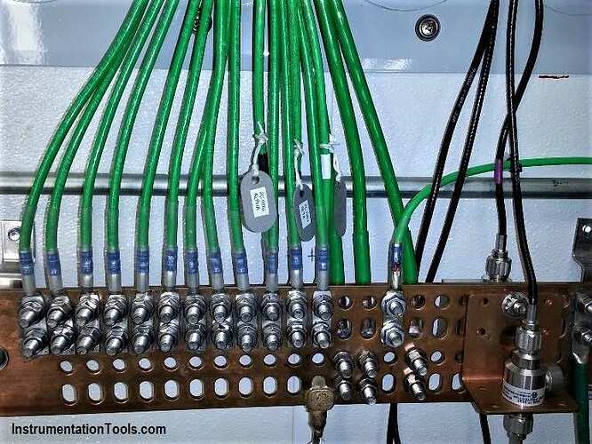

SIZE OF EARTH CONTINUITY CONDUCTORS
The size of earth continuity conductor depends on the size of cable that is to be protected.
The earth continuity conductor area should not be less than half of largest current carrying conductor supplying on the system

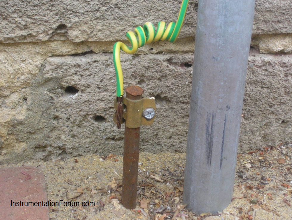

INSTALLATION OF EARTHING PLATES
The purpose of electrode is to provide good continuity with the earth at all time. The best method to maintain the continuity is the installation of plates at well below the level of water. This plate should be installed in the upright position in the ground and it should be surrounded by at least 1 foot of the mixture of charcoal and lime this leads to increment of the continuity.
In some situation coal can also be used but it is not a convenient method so, it should be used where charcoal is not present. We cannot use coke because it has a corrosive action.
Sometimes salt is also mixed with the mixture of charcoal and lime, but again it is not a good method because it also have a corrosive property. Although, salt increase the continuity, but for a particular time.
Normally, the center of the plate should be 10ft below the surface of the earth and at least 1ft below the water level. The depth of the plate should also depend upon the local conditions.

Earthing lead should be connected to the earthing electrodes by means of nuts and bolts.
