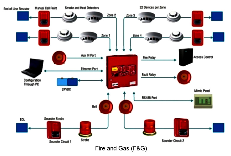

A Fire and Gas (F&G) detection system is a very wide-spread and effective SIS. It detects any danger in terms of fire or combustible / toxic gas leaks and takes action to minimize the danger and prevent it turning into a fire or explosion.
A F&G detection system continuously monitors all areas and provides the operator with the information of detection/protection systems. It gives warnings to personnel of any hazardous situation and takes action depending upon the level of hazard detected (process shutdown, fire extinguish release).

In order to design a suitable fire and gas detection system, a risk analysis has to be undertaken. The resulting reports will establish the requirements for the system: which type of detectors shall be used, the speed of detection response, how many fire zones / areas shall be defined, how the warning devices will work, what information is needed for the operator, are there any redundancy or SIL requirements, and so on.
