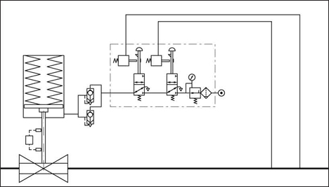

Integral Mechanical HIPPs systems - using Mechanical Initiators
In 1974 the German DVGW certified the Mokveld final element including mechanical initiators in accordance with EN 14382 (former DIN 3381). Since that date Mokveld has field experience with safety shut-off valves (with actuator and initiator) closing within 2 seconds. The main features of Mokveld’s integral mechanical HIPPS are;
• Integrated safety loop to IEC 61508 / EN 12186
• Safe and simple
• Option not requiring external energy (stand-alone HIPPS)
• No wiring required
• Set point accuracy < 1%
• System to SIL 3 or 4
• Third party validated failure data
