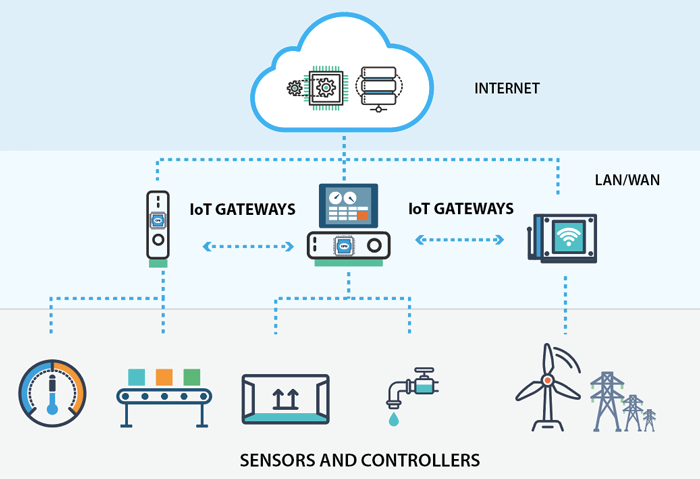

What is an IoT Gateway?
An IoT Gateway is a solution for enabling IoT communication, usually device -to-device communications or device-to-cloud communications. The gateway is typically a hardware device housing application software that performs essential tasks. At its most basic level, the gateway facilitates the connections between different data sources and destinations.
A simple way to conceive of an IoT Gateway is to compare it to your home or office network router or gateway. Such a gateway facilitates communication between your devices, maintains security and provides an admin interface where you can perform basic functions. An IoT Gateway does this and much more.

IoT Gateways and Edge Computing
In edge computing, critical data processing occurs at the data source rather than in a centralized cloud-based location. A versatile IoT Gateway is the essential link in delivering edge computing power to technicians in the field or at the plant floor. IoT Gateways that come equipped with these capabilities are referred to as ’Smart’ Gateways.
