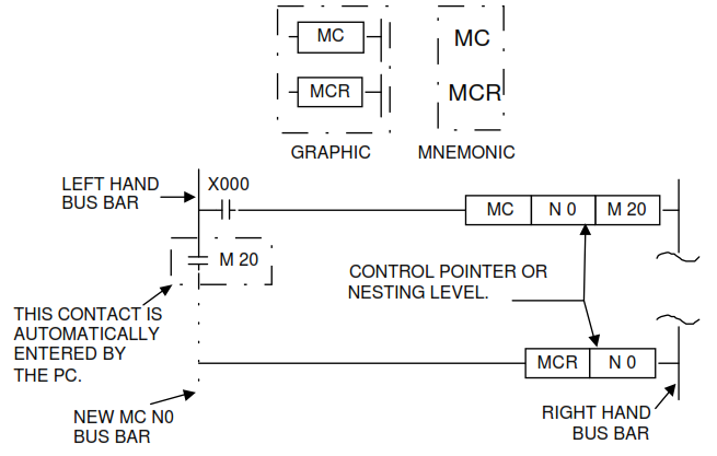

What do MC and MCR contacts look like?
In ladder format the MC and MCR instructions appear as shown in the following diagram. The diagram also shows the relative location where either an MC or an MCR can be found within a ladder rung.
