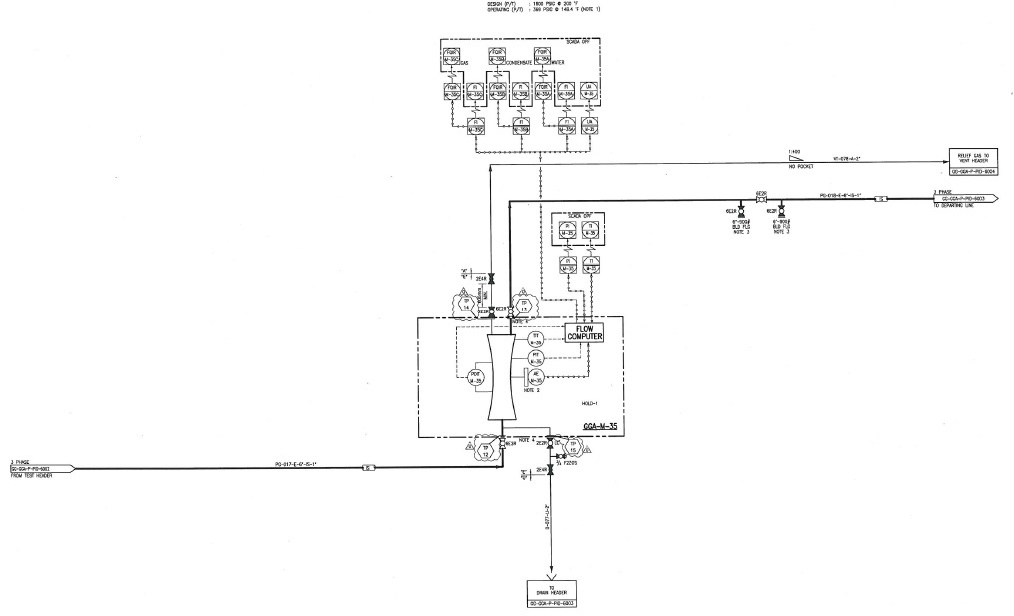

A typical Multi-phase flow meter P&ID looks a s below.
Along with multi phase flow meter there is also Well Head monitoring and shutdown control panel.
Generally Multi phase flow meter is used in upstream application at well Heads to determine properties of the Content of the well which has all the phases condensate, water and gasses.
