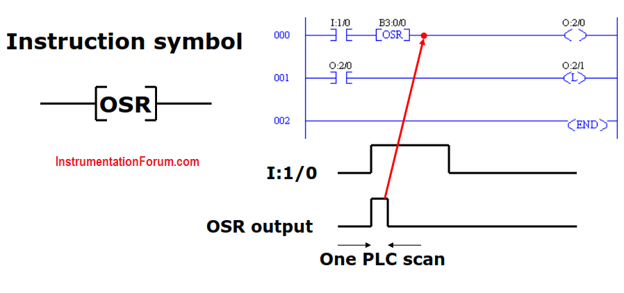

When the rung conditions preceding the One-shot rising (OSR) go from false-to-true, the OSR instruction goes true also but for only one scan.
The address on the OSR instruction is a bit that is used to reflect the state of the input to the One-shot rising (OSR).
