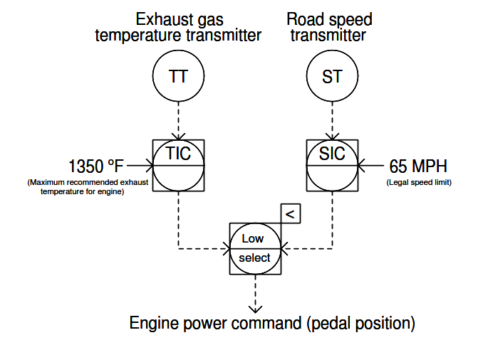

In other words, the legal speed limit is no longer the “setpoint” to control to, and EGT now is. If we were to model the truck driver’s decision-making processes in industrial instrumentation terms, it would look something like this:
Which ever control decision calls for the least engine power output, “wins the vote” to control
the engine’s power.
As is the case with limit and selector control strategies, a “select” function is used to choose one signal from multiple signals. The difference here is that the signals being selected are both controller outputs rather than transmitter (measurement) or setpoint signals. Both controllers are still active, but only one at a time will have any actual control over the process.
