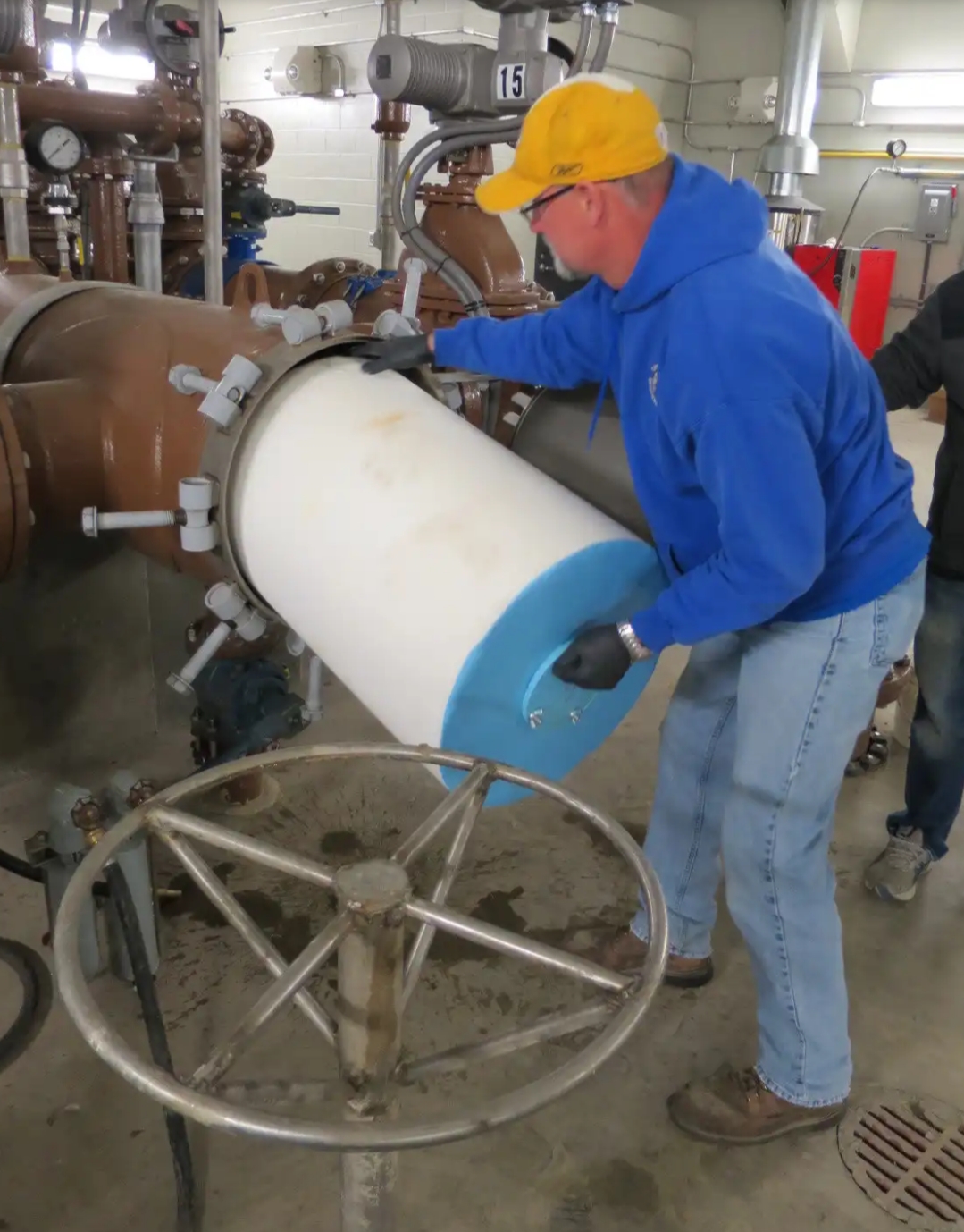

The pipeline pig is inserted into the pipe using a pig trap, which is typically oversized to accommodate the tight fitting pig. A similar pig trap or receiver is located at the end of the pipe to receive the pig once it has traveled the length of the pipeline.
