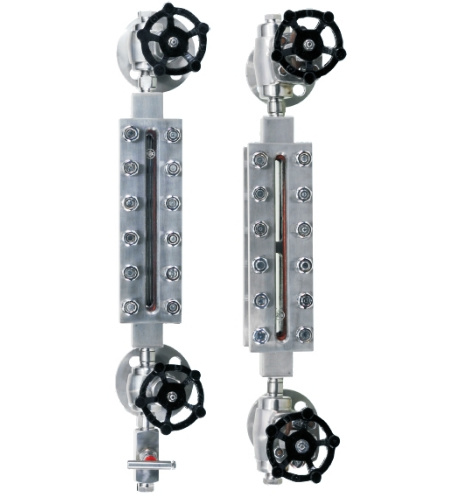

Reflex Level Gauge
In this type of level gauge the liquid level is discriminated in the form of different brightness of the light on the reflex glasses.
This is based on refractive indices of liquid and gas or vapor phase. In the liquid phase light is refracted to the glass and absorbed inside the gauge whereas in vapor phase light is reflected against the glass grooves and it appears very bright.
This type of gauge is mainly recommended for colourless liquid. The gauge consists of a body machined to have an internal chamber and one or more front windows only on one side of the gauge as shown in figure.
On each window a special high resistance plate reflex level glass is fitted with sealing joint and metal covers seized by ā€˜U’ Bolts and Nuts.
