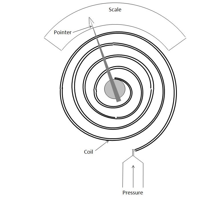

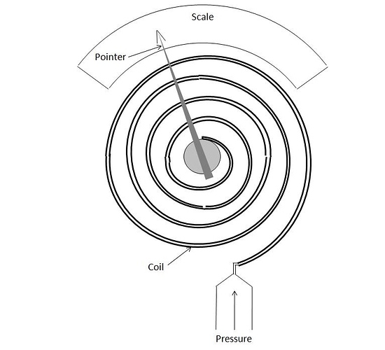

Spiral type measuring element Is used to measure pressure Ranges from 18 to 4000 psi
It is made of a thin walled tube flattened on opposite Side to produce an elliptical cross section then formed into a spiral when pressure is applied into the open end tube tends to uncoil The pointer is directly connected to the spiral to measure equivalent pressure reading.
