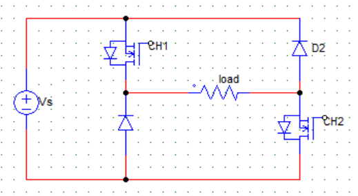

What is the load voltage value when both the chopper switches are on?
A. 0
B. Vs
C. 2Vs
D. Vs/2
Answer: B
A. 0
B. Vs
C. 2Vs
D. Vs/2
Answer: B
