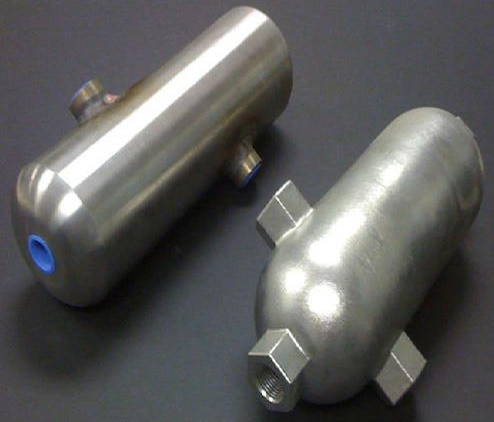

Condensate pots are indispensable for the measurement of steam.
They maintain a constant condensate head within the measuring line above the differential pressure transmitter in order to ensure an accurate measurement.
Condensate pots
Condensate pots is a pipe section which is installed horizontally at the orifice flange union to offer a huge flow surface area for the movement of the impulse line fluid with instrument element position variation.
It is particularly useful to minimize the measurement error for the hydrostatic head difference in the impulse line.
