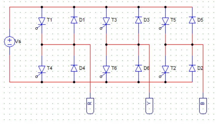

What is the voltage between the B phase and the neutral, when T2, T3 and T4 are conducting?
A. -2Vs/3
B. Vs/3
C. 2Vs/3
D. -Vs/3
