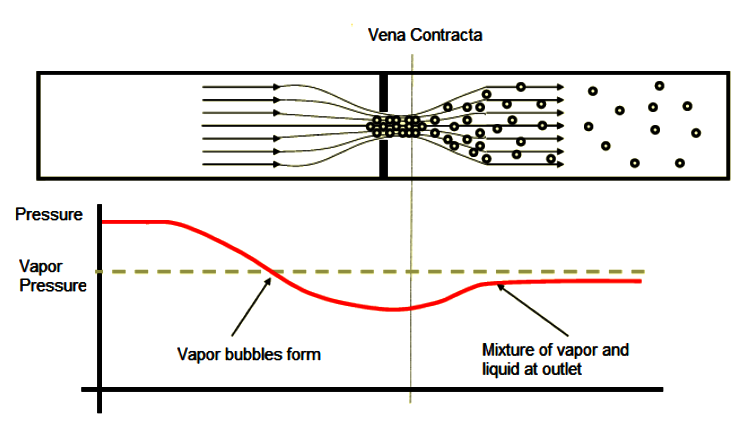

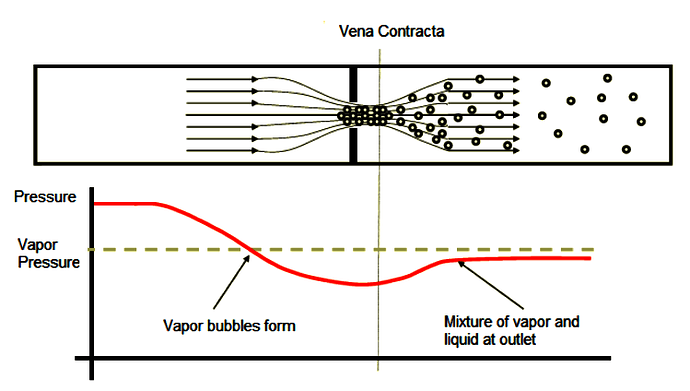

Valve Flashing
Requirements for occurrence of flashing:
The fluid at the inlet must be in all-liquid condition, but some vapor must be present at the valve outlet;
The fluid at the inlet may be in either a saturated or a subcooled condition; and
The valve outlet pressure must be either at or below the vapor pressure of the liquid.
Flashing effects:
Material damage is associated with the formation of sand-blasted surfaces;
Decreased efficiency - valve ability to convert pressure drop across the valve into mass flowrate is compromised.
How can flash damage be contained:
Under such scenario, there are two phases flowing downstream of the valve: liquid and vapor. Flashing cannot be eliminated in the valve if the downstream pressure is less than the vapor pressure of liquid.
However, the damage can be minimized by:
Hard face trim (using hard facing materials such as Stellite or Tungsten Carbide), more erosion resistant body material.
Increasing size of the valve, therefore reducing the velocity
Using angle valve – flow over plug
