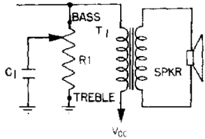

When the wiper of R1 is placed in the full ___
When the wiper of R1 is placed in the full treble position, which of the following actions occur?
1.68, 1B, Circuit
A. Bass response is improved
B. High frequency shunting is reduced
C. Higher frequencies are shunted to ground
D. The capacitor and resistor are placed in parallel
Answer: B
